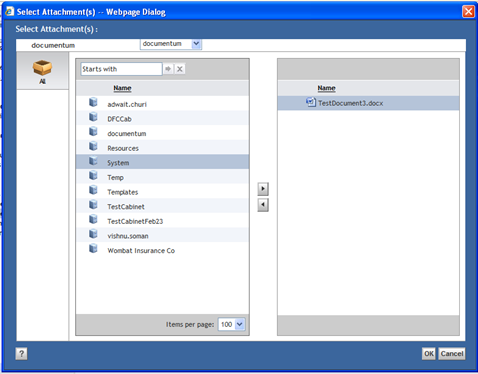

But now iam envisaging a way to save the files the into the Documentum Repository.The below given image will elucidate my idea.
The above given image is of the select 'additional' files functionality. Clicking on the right side pointed button in the middle helps in placing documents inside the Cabinets (seen on left) on the right pane.Clicking on the leftside pointed button in the middle helps in emptying the list of documents seen on the right side.
My queries based on this scenario are:
1) What is the name of this specific 'control' ? Or is this a combination of multiple components?
2) Is there a way i can modify the above screen so that i can facilitate copying the document inside a specific cabinet?
I have just started digging into the Quickflow code and its framework and have come across wfsysobjectlocatorcontainer_component.xml. and
<start>/webcomponent/library/locator/appintgsysobjectlocatorcontainer.jsp</start> as the jsp possibly rendering the above structure.
I hope i will get your confirmation on whether i am going about correct and your guidance as to how i can tweak the functionality to implement my requirement
