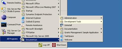

I am able to see the installed Documentum entities as seen below.
I would really appreciate if some one could suggest a solution to this.
