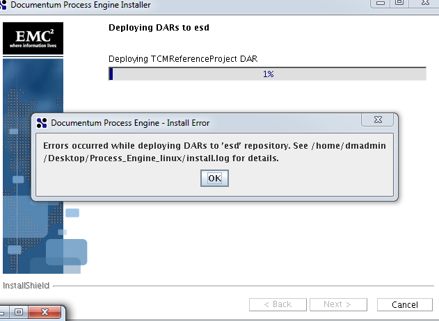

Hello Experts,
While installing process engine on linux RHEL 6.1 it trows error.
According to PE 6.7sp1 release notes, I have to run the dm_set_server_env.sh script to avoid this error.But I had run this befor installation again no luck.Please help me if you know what the problem is.
