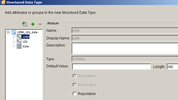

for this i create a next SDT:

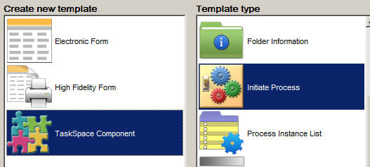

then create a new From Initiate Process type:
selecting my process template...

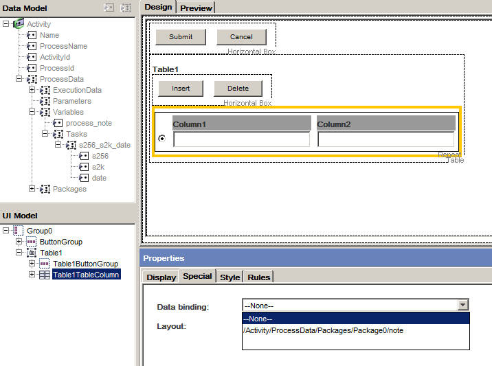

...and on Step "add TABLE element" into my Form, I can't selecting the data_model for "repeating" group my table:

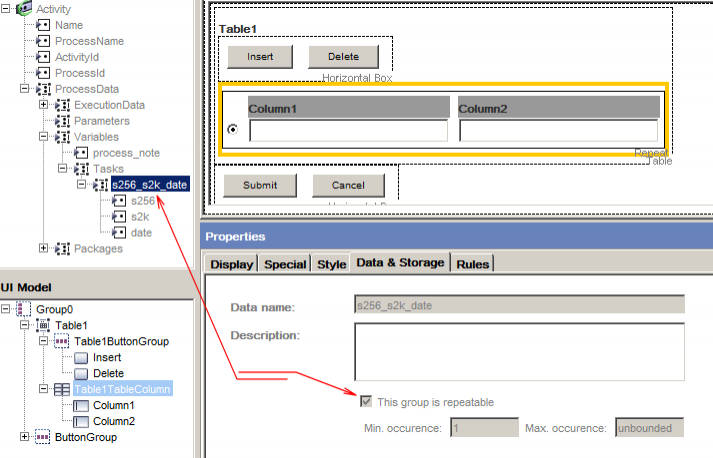

If I make as "repeatable" the "s256_s2k_date" node:

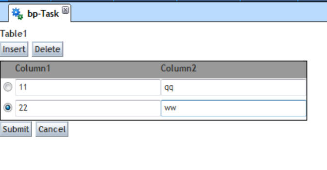

I get the desired INIT form:
but,

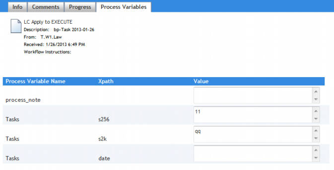

In the process, with this form gets only 1st value:

1. use a simple "Electronic Form" - only this Form Type can work with tables
