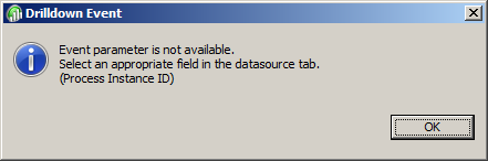

Hello, I´m using BAM Aggregation xCelerator to create custom reports. I need to use this custom entity in a muli-drilldown dashboard, but when I tried to configure PRS to add the event for a column, appears the following message:
It seems that PRS can´t find INSTANCEID in my custom entity, but the field was selected. To solve this problem I configure a relation betwen my custom entity and "Process Execution" entity using the DQL below (I change the DQL statment betwen [] into the real values):

It resolve the message into PRS. Then I configure Multi-drilldown in Taskspace with this dashlet (dashlet A) sending “Process Instance ID ”event to 2 other dahslets:
-another custom entity (dashlet
-Native “Process Diagram”
When I select a column in dashlet A, “Process Diagram” works fine, but in dashlet B appers this message:
So the problems are:
1-how I configure a “Process Instance Event” in a custom entity.
2-what I´m doing wrong with multi-drilldown configuration in dashlet B.
Please, HELP !
