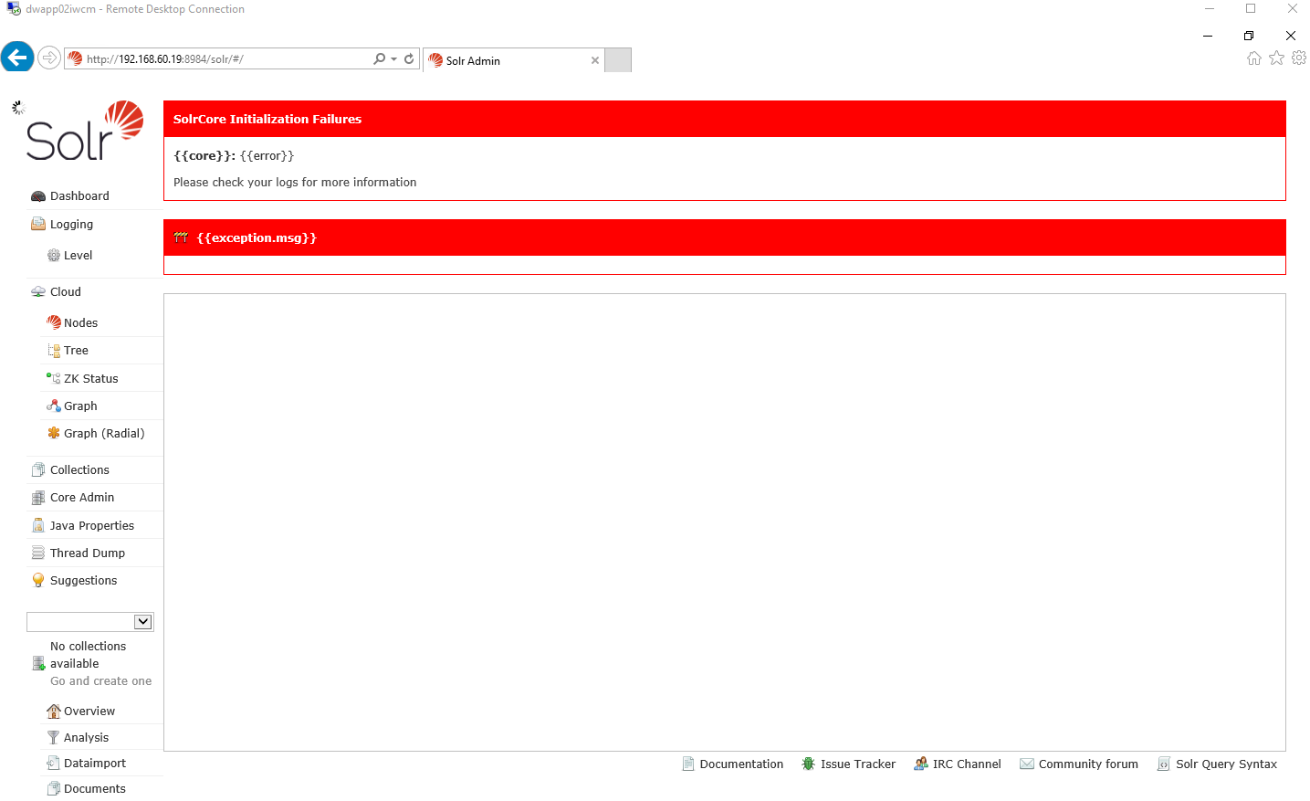

I am going to try cranking up the debugging here:
\DWxxxxxxxxxxxx\Interwoven\ApplicationContainer\standalone\deployments\iw-cc.war\WEB-INF\conf\search\log4j.xmlI am able to access the SOLR dashboard UI from the TS server, i.e. http://192.168.xx.xx:8983/solr/. However, it has an error on the homepage (see screencap):
SolrCore Initialization Failures
{{core}}: {{error}}Please check your logs for more information
{{exception.msg}}
Either way I will get a case going also - thanks Kenzer!
0 -
1) all 4 services are up (zk, solr1, solr2, indexer)
2) i cannot access the localhost:8983 on the search server itself which is weird (they have these servers really locked down)i googled a few things and it appears it might be an IE/javascript issue. i am going to talk to our sysadmins...
https://stackoverflow.com/questions/56262704/solr-solrcore-initialization-failures-core-errordoes solr/zookeper/etc need internet access to external sites? as i mentioned these servers/firewall are locked down pretty tightly. we ran into an issue with the TS install was reaching out to the spring site and wouldnt install without us changing firewall rules (WCM-24695)
the weird thing is i can access is using the IP address from the TeamSite server.
