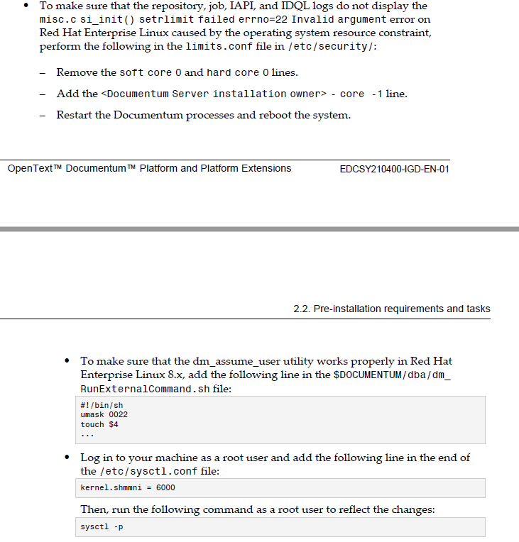

I made few changes and got the above errors :
- I move the dfc related folders/files from /documentum to /doc_shared
- Made these changes on the server as given
Please let me know what changes needs be to reverted. As before these the repository is up and running.
