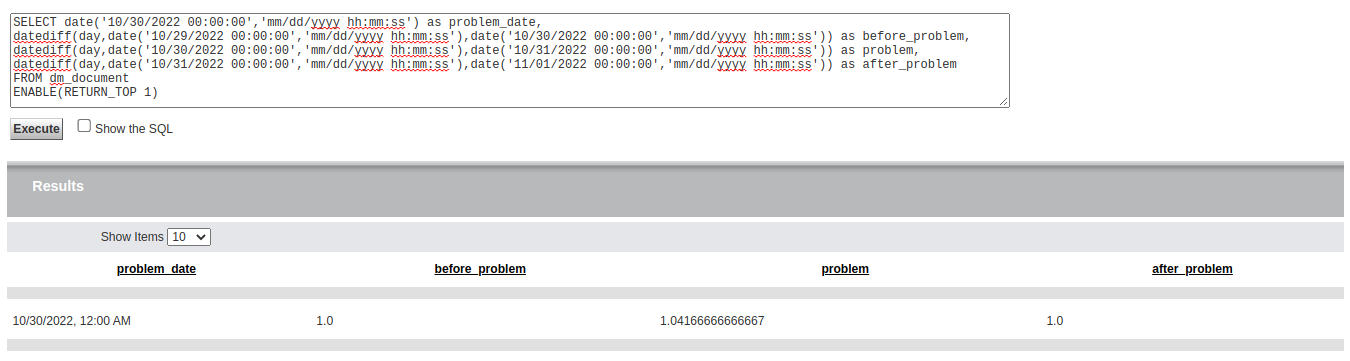

Below the used DQL statement and the result:
SELECT date('10/30/2022 00:00:00','mm/dd/yyyy hh:mm:ss') as problem_date,
datediff(day,date('10/29/2022 00:00:00','mm/dd/yyyy hh:mm:ss'),date('10/30/2022 00:00:00','mm/dd/yyyy hh:mm:ss')) as before_problem,
datediff(day,date('10/30/2022 00:00:00','mm/dd/yyyy hh:mm:ss'),date('10/31/2022 00:00:00','mm/dd/yyyy hh:mm:ss')) as problem,
datediff(day,date('10/31/2022 00:00:00','mm/dd/yyyy hh:mm:ss'),date('11/01/2022 00:00:00','mm/dd/yyyy hh:mm:ss')) as after_problem
FROM dm_document
ENABLE(RETURN_TOP 1)
Is there anyone which can answer why the datediff adds 0.0416667 days when you would normally expect that 30 and 31 October are 1 day apart?
