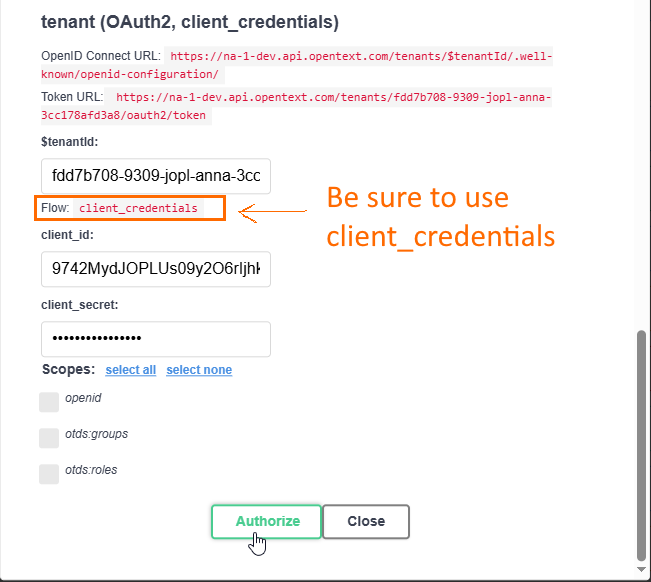

Hi @Balaram Barada, I see you're using the 'authorization_code' flow. Normally you would use the 'client_credentials' flow. Can you try that? Something like this:

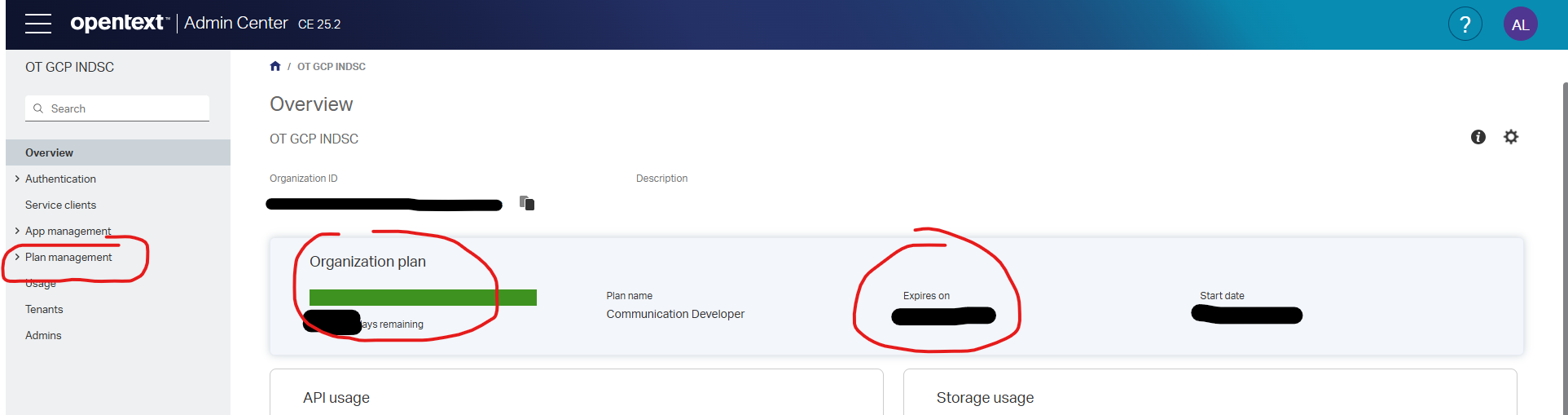

This usually means that the client_id is not authorized for the specific tenant. Can you check, in Admin center, that you have an active plan, that your application is not expired and that you can access your tenant and app?

e. Check that you still have a developer plan valid and it is not expired. Then, go to the "Plan management" → "Plans" and make sure you have at least a Developer plan that is not expired.

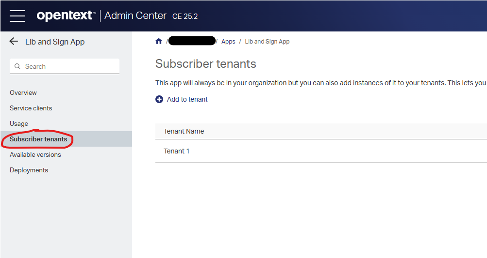

h. Click on Subscriber tenants and check that the tenant ID you are using in the Auth URL is present there:
i: Now, you can test the Authentication by using the authentication URL for your region (see step c) and this article: https://developer.opentext.com/cloud-platform/documentation/authentication , use the client_credentials grant type, client_id from step g and secret that you saved when the application was created. If you don't have it anymore, you can always regenerate the Confidential Client ID.
