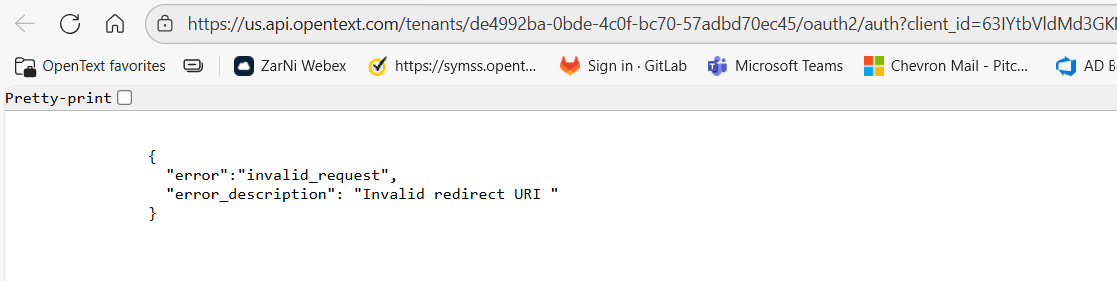

Thanks for your reply. I have updated the environment variables but ended up like this.
This error indicates that you need to allow your redirect url for the application service client. In Admin Center open the service client config op de app you created and add your redirect url (https://localhost:4000 most likely looking at your screenshot).

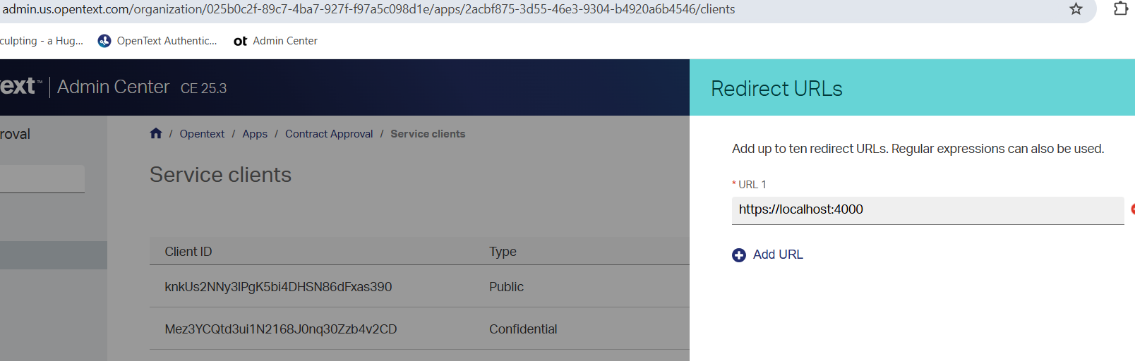

I have already configured the Redirect URL for the specific app in service client, still the issue persists
Check the app configuration and make sure that you specified the correct service client. Your .env should have the Public Client ID. Looking at your above screenshot it seems you're using a different client.
I have mistakenly used the global public ID instead of App public ID.
