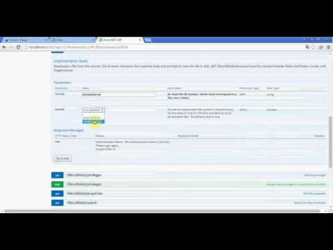

<p>Thank you for answer my topic, but i still can't solve this probem. what happened with me show in below video, can you help me !!</p>
<p><a data-ipb='nomediaparse' href='https://youtu.be/Y4vR4NuujBs'>https://youtu.be/Y4vR4NuujBs</a></p>

<p>As I mentioned in the previous posts, when you using the REST API v2 UI, the download in the response body needs on extra manual step. I did not see that in the video.</p>
<p> </p>
<p>So instead of (left) clicking on the link you did @ 1:20, please right click on the link.</p>
<p> </p>
<p>Then choose the option "Save link as..." (Firefox), or "Save as..." (Chrome).</p>
<p> </p>
<p>Name the file, and give the file a .PDF extension name.</p>
<p> </p>
<p> </p>
<p>If you're not using the REST API v2 UI, then you'll need to use the HTML5 download attribute.</p>
