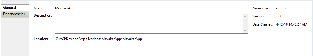

    I mean, the version you put in xCP designer. click on model. then in the properties pane, bottom right. I don't have an xCP designer on hand, so can't give you screenshot.

  • kfirswisa
    edited March 6, 2019 #7
    @kgentens said:
    Well, it should not give you any issues. I also encountered this problem after creating new inbound processes.
    you speaking about that:
    i changed it, same error
