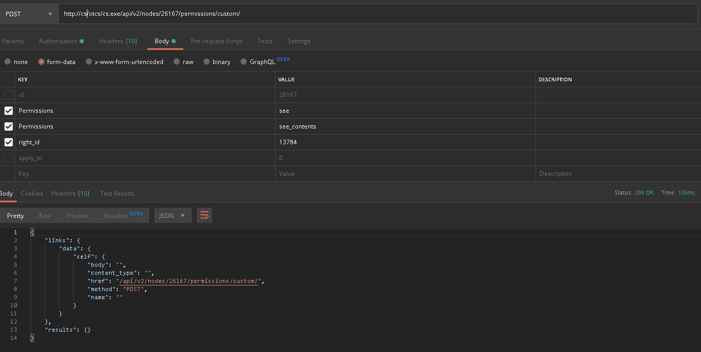

Hi there
the problem here is that the Permissions key refers to an array.
one way (not sure if the only one) to give values to an array in from-data using postman is the following :
... Permissions --> value 1 Permissions --> value 2 etc ...
hope this helps. Cheers
