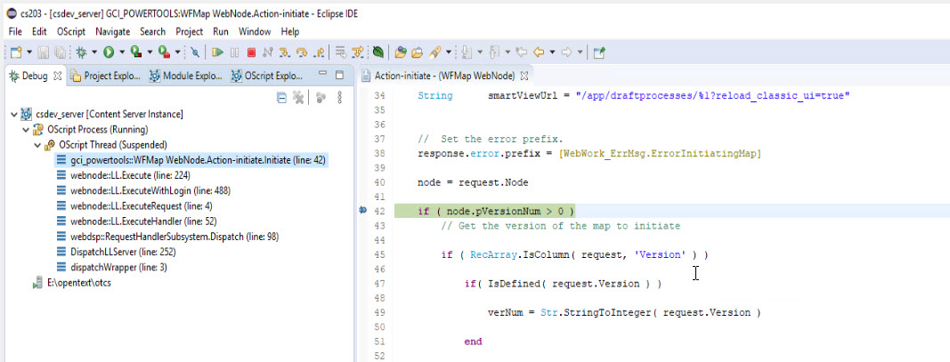

When we try to debug , eclipse is getting prompted at the break point location, but its showing resource does not exist, other codes are able to connect to source code and working in the hierarchy. Attached screen snapshot for reference

If you could expand the folder #dd000417 under GCI_POWERTOOLS as shown in your screenshot and check the files in it. My guess is it contains a file "Action-Initiate" instead of "Action-initiate".
If that is the case, then we are talking about the same issue and there will be a fix in the next CSIDE update (21.3).
The 20.4 release had indeed a few changes around the handling of those temp files.
The issue may go away, if you adjust the name of that script, for example use all lower-case letters. But I cannot guarantee that this helps in all cases.

Yes renaming the temp file does fix the issue.
