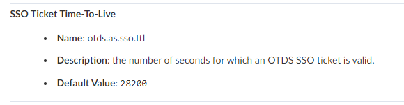

Do you know how to extend the OTDS token time? I would ideally set it super high during the migration and then set it back to its default, if possible.

BTW the 7.8 hrs will not be useful because if CS says expire cookie in 30 mins from last request i am not sure if it will honor the 28200 in which case I don't know what it will go by.
