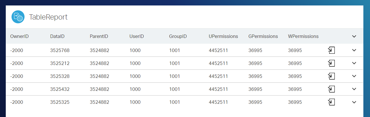

I assume you are using the new "Content Intelligence -> Table Report", is that correct?
Does your widget look like the picture above?
