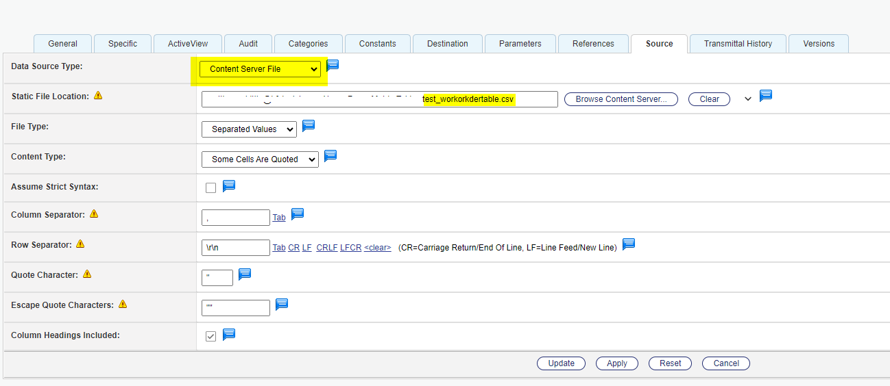

I created a webreport and set a csv file as data source and Form Report as a reportview file but the when I hit add then click on the webreport, I get 5 columns marked unknown column and with 100 rows with *invalid tag* , where can I use SETFORM and how to use it? (sorry for bothering with these questions)
