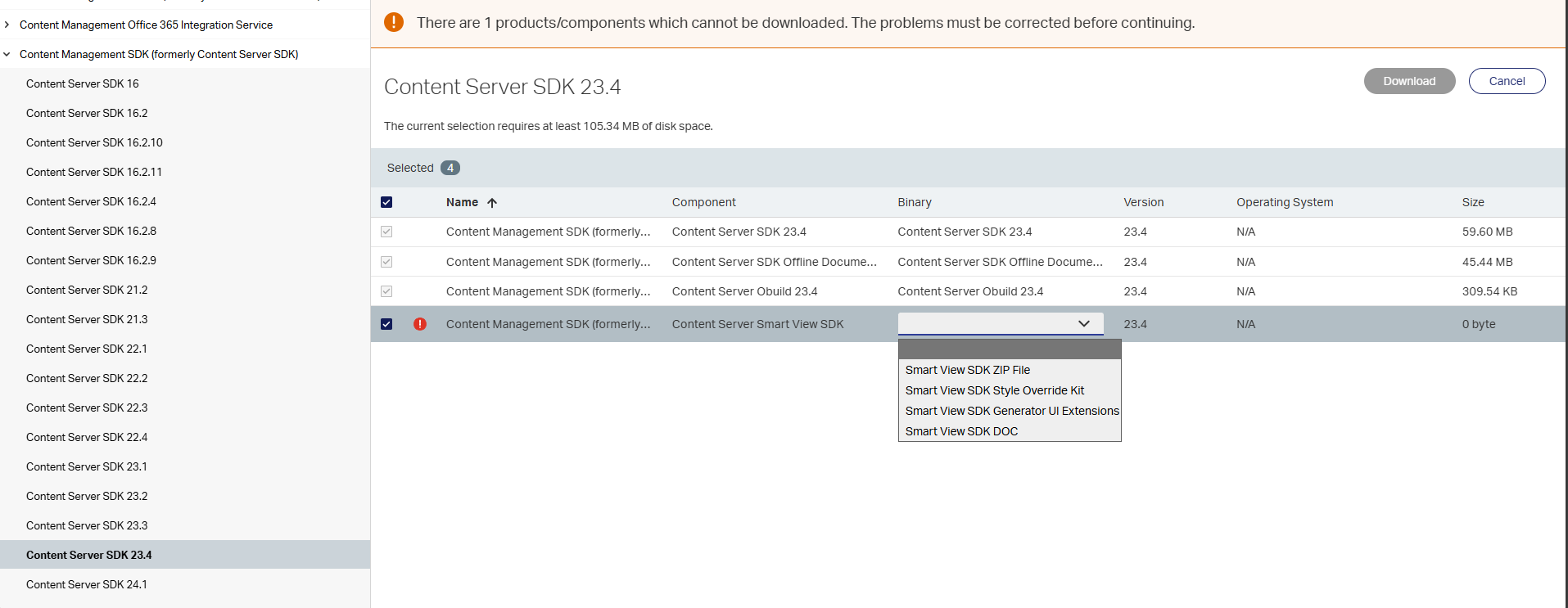

If you have never used SC I would advise you to attend a webinar on how to use it that will be helpful as it is somewhat all over the place :).To get it one needs a paying account with KB. Here's how I found it for you now.I click the Knowledge/Software downloads . Then I click the Facet on the Product. If you now put it on a decent Windows computer you will after doing all the pre reqs click on its catalog and when you reach Content Server you will see the SDK.

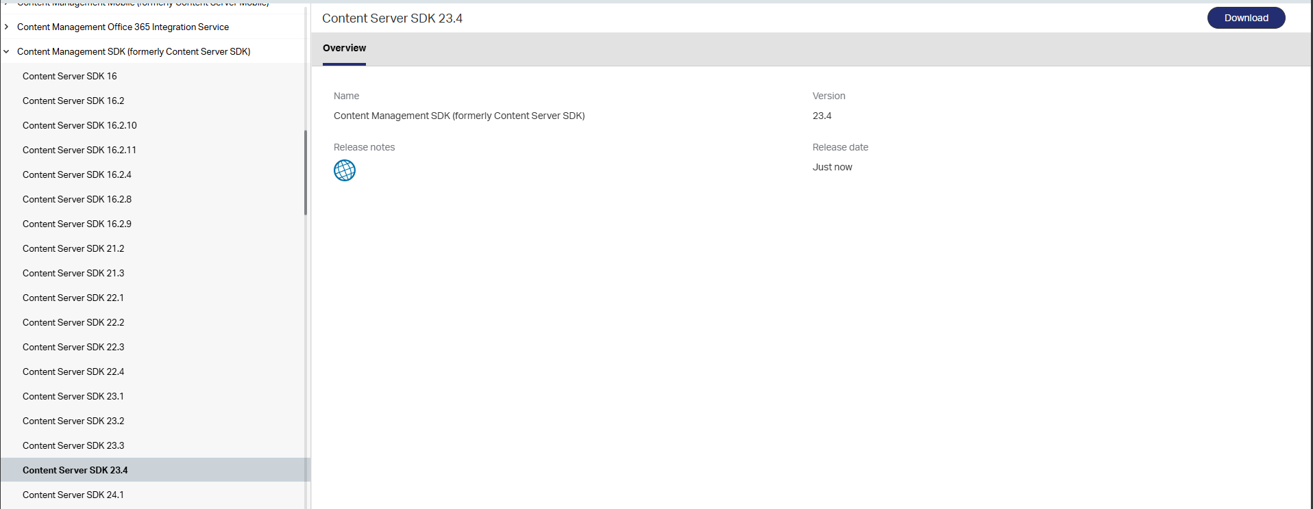

The SDK release 23.4 can be found here
For the future releases you can visit simply this link and choose version in a filter
It is the Extended ECM and Extended ECM Platform filter0 -
Hi Vit,
Actually, System Center is relevant here as Appu points out - and I for one would like to thank Appu for just making my life that much easier 😃
You can actually use System Center to directly download the Content Suite SDK including the Smart View components.
In System Center, open the Catalog of products, find the Content Server SDK version and select. The right pane will now list the varying SDK components (i.e. CSIDE, documentation, Obuild and Smart View). The Smart View option then has sub-options to retrieve a ZIP (I assume all bits), the Style Override Kit, the CSUI Generator (the bit you're after) and the documentation.
Of course be sure to update the manifest in System Center if version you're looking for doesn't appear. Note that this also doesn't mean if its not shown it's not available - obviously there can be lag between OT releasing the SDK and the manifest for SC being updated!
Much easier this way that having to muddle way through the Support Portal.
