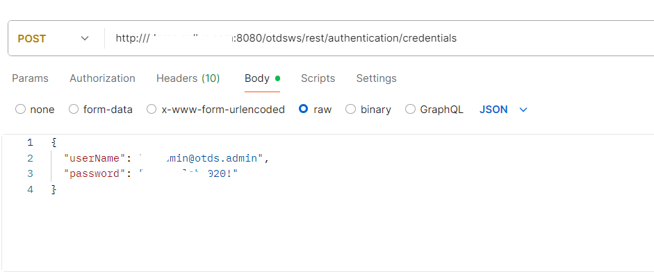

Step 1 — Get an OTDS SSO Ticket for the Service Account
Use the /authentication/credentials endpoint — NOT the OAuth2 /oauth2/token endpoint. This returns a legacy *OTDSSSO* or *VER2* format ticket rather than a JWT.
POST /otdsws/rest/authentication/credentialsContent-Type: application/json{ "userName": "YOUR-SERVICE-ACCOUNT@OAuthClients", "password": "YOUR-CLIENT-SECRET"}
PowerShell:
$auth = Invoke-RestMethod -Method Post ` -Uri "https://YOUR-OTDS/otdsws/rest/authentication/credentials" ` -ContentType "application/json" ` -Body '{"userName":"YOUR-SERVICE-ACCOUNT@OAuthClients","password":"YOUR-SECRET"}'
The response includes a ticket field starting with *OTDSSSO* or *VER2*. This ticket can be reused to generate multiple impersonated tickets until it expires (1 hour).
